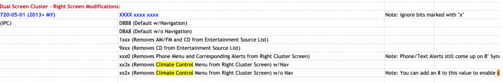

Gadgetjq Posted September 26, 2019 Report Share Posted September 26, 2019 (edited) 9 hours ago, 1004ron said: A while back I drove a rental Expedition and it showed gear position all the time - is there a way to do the same on the Ed There's this. It looks like you'd put either an 8 or a 9 in that 4th position for the display(s) you're looking for. No guarantees it'll work but give it a shot if you want and let the rest of us know what happens: IPC New 720-09-01 xxx* xxxx xxxx Target Gear Indication (TGI), Gear Range (GR), Gear and Range Display LO (GRD) 0=TGI disabled, GR 6-speed, GRD disabled 8=TGI enabled, GR 6-speed, GRD disabled 1=TGI disabled, GR 6-speed, GRD enabled 9=TGI enabled, GR 6-speed, GRD enabled 2=TGI disabled, GR 10-speed, GRD disabled A=TGI enabled, GR 10-speed, GRD disabled 3=TGI disabled, GR 10-speed, GRD enabled B=TGI enabled, GR 10-speed, GRD enabled 4=TGI disabled, GR not used, GRD disabled C=TGI enabled, GR not used, GRD disabled 5=TGI disabled, GR not used, GRD enabled D=TGI enabled, GR not used, GRD enabled 6=TGI disabled, GR not used, GRD disabled E=TGI enabled, GR not used, GRD disabled 7=TGI disabled, GR not used, GRD enabled F=TGI enabled, GR not used, GRD enabled Edited September 26, 2019 by Gadgetjq 2 Quote Link to comment Share on other sites More sharing options...
omar302 Posted September 27, 2019 Report Share Posted September 27, 2019 16 hours ago, Gadgetjq said: There's this. It looks like you'd put either an 8 or a 9 in that 4th position for the display(s) you're looking for. No guarantees it'll work but give it a shot if you want and let the rest of us know what happens: IPC New 720-09-01 xxx* xxxx xxxx Target Gear Indication (TGI), Gear Range (GR), Gear and Range Display LO (GRD) 0=TGI disabled, GR 6-speed, GRD disabled 8=TGI enabled, GR 6-speed, GRD disabled 1=TGI disabled, GR 6-speed, GRD enabled 9=TGI enabled, GR 6-speed, GRD enabled 2=TGI disabled, GR 10-speed, GRD disabled A=TGI enabled, GR 10-speed, GRD disabled 3=TGI disabled, GR 10-speed, GRD enabled B=TGI enabled, GR 10-speed, GRD enabled 4=TGI disabled, GR not used, GRD disabled C=TGI enabled, GR not used, GRD disabled 5=TGI disabled, GR not used, GRD enabled D=TGI enabled, GR not used, GRD enabled 6=TGI disabled, GR not used, GRD disabled E=TGI enabled, GR not used, GRD disabled 7=TGI disabled, GR not used, GRD enabled F=TGI enabled, GR not used, GRD enabled I just tried. It doesn't work on my 2016 Sport. My default value is "0", changing to 8 or 9 gives an error for incompatible configuration. 3 Quote Link to comment Share on other sites More sharing options...
Gadgetjq Posted September 27, 2019 Report Share Posted September 27, 2019 5 hours ago, omar302 said: I just tried. It doesn't work on my 2016 Sport. My default value is "0", changing to 8 or 9 gives an error for incompatible configuration. Disappointing but good to know. Thanks for the feedback! Quote Link to comment Share on other sites More sharing options...
MajorWroth Posted September 27, 2019 Report Share Posted September 27, 2019 (edited) What about using 1 instead of 8 or 9? I'm not sure exactly what TGI vs GRD means but maybe it could give you something? Edited September 27, 2019 by MajorWroth Quote Link to comment Share on other sites More sharing options...
omar302 Posted September 27, 2019 Report Share Posted September 27, 2019 3 hours ago, MajorWroth said: What about using 1 instead of 8 or 9? I'm not sure exactly what TGI vs GRD means but maybe it could give you something? Since these were taken from the F-150, I guessed that TGI is for the current gear indicator and GRD is for displaying the current range of allowed gears. The 2nd one is a feature on the F-150 that allows the driver to pick out higher gears that are locked out, hence the the display of allowed range of gears. Quote Link to comment Share on other sites More sharing options...
